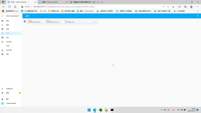

拿其中一个例子来说明问题,大佬帮看看,问题原因在哪里吧。
一、问题描述
我这个小米门磁的光照和打开关闭状态,就显示“不可用”,截图如下:
二、相关的配置
2.1 这个小米门磁是xiaomi gateway3集成里的一个设备
image|690x388
2.2 这个xiaomi gateway3集成版本是V2.1.1的(前两天升级到V2.1.2时不可用的更多,所以又降到V2.1.1),截图如下
2.3 这个实体的日志,好像啥也没有,因为我恢复了到几天前的状态了
大佬能看出问题所在不?要不要截图其它的画面呢?

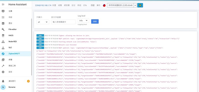

請問zigbee2mqtt之前常無法連線,現在重新安裝後,顯示無法啟動。
日誌如下:
[12:26:30] INFO: Preparing to start…
[12:26:32] INFO: Socat not enabled
[12:26:39] INFO: Starting Zigbee2MQTT…
Zigbee2MQTT:error 2022-10-16 12:26:57: Error while starting zigbee-herdsman
Zigbee2MQTT:error 2022-10-16 12:26:57: Failed to start zigbee
Zigbee2MQTT:error 2022-10-16 12:26:57: Check Zigbee2MQTT fails to start | Zigbee2MQTT for possible solutions
Zigbee2MQTT:error 2022-10-16 12:26:57: Exiting…
Zigbee2MQTT:error 2022-10-16 12:26:57: undefined
請教zigbee2mqtt目前有成功啟動,但再搜尋新設備時卻都找不到。使用z2m則都能正常,所以確定網關是好的,我該怎麼處理呢?
[18:23:22] INFO: Preparing to start…
[18:23:24] INFO: Socat not enabled
[18:23:29] INFO: Starting Zigbee2MQTT…
Zigbee2MQTT:info 2022-10-16 18:23:36: Logging to console and directory: ‘/config/zigbee2mqtt/log/2022-10-16.18-23-36’ filename: log.txt
Zigbee2MQTT:info 2022-10-16 18:23:37: Starting Zigbee2MQTT version 1.28.0 (commit #unknown)
Zigbee2MQTT:info 2022-10-16 18:23:37: Starting zigbee-herdsman (0.14.62)
Zigbee2MQTT:info 2022-10-16 18:23:48: zigbee-herdsman started (resumed)
Zigbee2MQTT:info 2022-10-16 18:23:48: Coordinator firmware version: ‘{“meta”:{“maintrel”:1,“majorrel”:2,“minorrel”:7,“product”:1,“revision”:20210319,“transportrev”:2},“type”:“zStack3x0”}’
Zigbee2MQTT:info 2022-10-16 18:23:48: Currently 0 devices are joined:
Zigbee2MQTT:info 2022-10-16 18:23:48: Zigbee: disabling joining new devices.
Zigbee2MQTT:info 2022-10-16 18:23:48: Connecting to MQTT server at mqtt://192.168.1.74:1883
Zigbee2MQTT:info 2022-10-16 18:23:49: Connected to MQTT server
Zigbee2MQTT:info 2022-10-16 18:23:49: MQTT publish: topic ‘zigbee2mqtt/bridge/state’, payload ‘online’
Zigbee2MQTT:info 2022-10-16 18:23:49: Started frontend on port 0.0.0.0:8099
Zigbee2MQTT:info 2022-10-16 18:23:49: MQTT publish: topic ‘zigbee2mqtt/bridge/config’, payload ‘{“commit”:“unknown”,“coordinator”:{“meta”:{“maintrel”:1,“majorrel”:2,“minorrel”:7,“product”:1,“revision”:20210319,“transportrev”:2},“type”:“zStack3x0”},“log_level”:“info”,“network”:{“channel”:11,“extendedPanID”:“0x00124b0022810f66”,“panID”:6754},“permit_join”:false,“version”:“1.28.0”}’
Zigbee2MQTT:info 2022-10-16 18:24:33: Zigbee: allowing new devices to join.
Zigbee2MQTT:info 2022-10-16 18:24:33: MQTT publish: topic ‘zigbee2mqtt/bridge/response/permit_join’, payload ‘{“data”:{“time”:254,“value”:true},“status”:“ok”,“transaction”:“8as2h-1”}’
Zigbee2MQTT:info 2022-10-16 18:24:56: Starting network scan (includeRoutes ‘false’)
Zigbee2MQTT:info 2022-10-16 18:24:57: Network scan finished
Zigbee2MQTT:info 2022-10-16 18:24:57: MQTT publish: topic ‘zigbee2mqtt/bridge/response/networkmap’, payload ‘{“data”:{“routes”:false,“type”:“raw”,“value”:{“links”:[{“depth”:1,“linkquality”:170,“lqi”:170,“relationship”:1,“routes”:[],“source”:{“ieeeAddr”:“0x6f000e72a442a5dd”,“networkAddress”:13},“sourceIeeeAddr”:“0x6f000e72a442a5dd”,“sourceNwkAddr”:13,“target”:{“ieeeAddr”:“0x00124b0022810f66”,“networkAddress”:0},“targetIeeeAddr”:“0x00124b0022810f66”},{“depth”:1,“linkquality”:170,“lqi”:170,“relationship”:1,“routes”:[],“source”:{“ieeeAddr”:“0x54ef4410004769b8”,“networkAddress”:35720},“sourceIeeeAddr”:“0x54ef4410004769b8”,“sourceNwkAddr”:35720,“target”:{“ieeeAddr”:“0x00124b0022810f66”,“networkAddress”:0},“targetIeeeAddr”:“0x00124b0022810f66”},{“depth”:1,“linkquality”:170,“lqi”:170,“relationship”:1,“routes”:[],“source”:{“ieeeAddr”:“0x72fffebbe2a95a60”,“networkAddress”:23554},“sourceIeeeAddr”:“0x72fffebbe2a95a60”,“sourceNwkAddr”:23554,“target”:{“ieeeAddr”:“0x00124b0022810f66”,“networkAddress”:0},“targetIeeeAddr”:“0x00124b0022810f66”},{“depth”:1,“linkquality”:170,“lqi”:170,“relationship”:1,“routes”:[],“source”:{“ieeeAddr”:“0xf9fffe908348a668”,“networkAddress”:46307},“sourceIeeeAddr”:“0xf9fffe908348a668”,“sourceNwkAddr”:46307,“target”:{“ieeeAddr”:“0x00124b0022810f66”,“networkAddress”:0},“targetIeeeAddr”:“0x00124b0022810f66”},{“depth”:1,“linkquality”:170,“lqi”:170,“relationship”:1,“routes”:[],“source”:{“ieeeAddr”:“0x00158d0003cc41c5”,“networkAddress”:12194},“sourceIeeeAddr”:“0x00158d0003cc41c5”,“sourceNwkAddr”:12194,“target”:{“ieeeAddr”:“0x00124b0022810f66”,“networkAddress”:0},“targetIeeeAddr”:“0x00124b0022810f66”},{“depth”:1,“linkquality”:170,“lqi”:170,“relationship”:1,“routes”:[],“source”:{“ieeeAddr”:“0xec1bbdfffe8d0efa”,“networkAddress”:24409},“sourceIeeeAddr”:“0xec1bbdfffe8d0efa”,“sourceNwkAddr”:24409,“target”:{“ieeeAddr”:“0x00124b0022810f66”,“networkAddress”:0},“targetIeeeAddr”:“0x00124b0022810f66”},{“depth”:1,“linkquality”:170,“lqi”:170,“relationship”:1,“routes”:[],“source”:{“ieeeAddr”:“0x38b0c39d1ee20494”,“networkAddress”:42177},“sourceIeeeAddr”:“0x38b0c39d1ee20494”,“sourceNwkAddr”:42177,“target”:{“ieeeAddr”:“0x00124b0022810f66”,“networkAddress”:0},“targetIeeeAddr”:“0x00124b0022810f66”},{“depth”:1,“linkquality”:170,“lqi”:170,“relationship”:1,“routes”:[],“source”:{“ieeeAddr”:“0xa4c138b0c39d1ee2”,“networkAddress”:1172},“sourceIeeeAddr”:“0xa4c138b0c39d1ee2”,“sourceNwkAddr”:1172,“target”:{“ieeeAddr”:“0x00124b0022810f66”,“networkAddress”:0},“targetIeeeAddr”:“0x00124b0022810f66”},{“depth”:1,“linkquality”:170,“lqi”:170,“relationship”:1,“routes”:[],“source”:{“ieeeAddr”:“0xb4e3f9fffe908348”,“networkAddress”:42600},“sourceIeeeAddr”:“0xb4e3f9fffe908348”,“sourceNwkAddr”:42600,“target”:{“ieeeAddr”:“0x00124b0022810f66”,“networkAddress”:0},“targetIeeeAddr”:“0x00124b0022810f66”}],“nodes”:[{“definition”:null,“failed”:[],“friendlyName”:“Coordinator”,“ieeeAddr”:“0x00124b0022810f66”,“lastSeen”:null,“networkAddress”:0,“type”:“Coordinator”}]}},“status”:“ok”,“transaction”:“8as2h-2”}’
Zigbee2MQTT:info 2022-10-16 18:25:06: Starting network scan (includeRoutes ‘false’)
Zigbee2MQTT:info 2022-10-16 18:25:07: Network scan finished
Zigbee2MQTT:info 2022-10-16 18:25:07: MQTT publish: topic ‘zigbee2mqtt/bridge/response/networkmap’, payload ‘{“data”:{“routes”:false,“type”:“raw”,“value”:{“links”:[{“depth”:1,“linkquality”:170,“lqi”:170,“relationship”:1,“routes”:[],“source”:{“ieeeAddr”:“0x6f000e72a442a5dd”,“networkAddress”:13},“sourceIeeeAddr”:“0x6f000e72a442a5dd”,“sourceNwkAddr”:13,“target”:{“ieeeAddr”:“0x00124b0022810f66”,“networkAddress”:0},“targetIeeeAddr”:“0x00124b0022810f66”},{“depth”:1,“linkquality”:170,“lqi”:170,“relationship”:1,“routes”:[],“source”:{“ieeeAddr”:“0x54ef4410004769b8”,“networkAddress”:35720},“sourceIeeeAddr”:“0x54ef4410004769b8”,“sourceNwkAddr”:35720,“target”:{“ieeeAddr”:“0x00124b0022810f66”,“networkAddress”:0},“targetIeeeAddr”:“0x00124b0022810f66”},{“depth”:1,“linkquality”:170,“lqi”:170,“relationship”:1,“routes”:[],“source”:{“ieeeAddr”:“0x72fffebbe2a95a60”,“networkAddress”:23554},“sourceIeeeAddr”:“0x72fffebbe2a95a60”,“sourceNwkAddr”:23554,“target”:{“ieeeAddr”:“0x00124b0022810f66”,“networkAddress”:0},“targetIeeeAddr”:“0x00124b0022810f66”},{“depth”:1,“linkquality”:170,“lqi”:170,“relationship”:1,“routes”:[],“source”:{“ieeeAddr”:“0xf9fffe908348a668”,“networkAddress”:46307},“sourceIeeeAddr”:“0xf9fffe908348a668”,“sourceNwkAddr”:46307,“target”:{“ieeeAddr”:“0x00124b0022810f66”,“networkAddress”:0},“targetIeeeAddr”:“0x00124b0022810f66”},{“depth”:1,“linkquality”:170,“lqi”:170,“relationship”:1,“routes”:[],“source”:{“ieeeAddr”:“0x00158d0003cc41c5”,“networkAddress”:12194},“sourceIeeeAddr”:“0x00158d0003cc41c5”,“sourceNwkAddr”:12194,“target”:{“ieeeAddr”:“0x00124b0022810f66”,“networkAddress”:0},“targetIeeeAddr”:“0x00124b0022810f66”},{“depth”:1,“linkquality”:170,“lqi”:170,“relationship”:1,“routes”:[],“source”:{“ieeeAddr”:“0xec1bbdfffe8d0efa”,“networkAddress”:24409},“sourceIeeeAddr”:“0xec1bbdfffe8d0efa”,“sourceNwkAddr”:24409,“target”:{“ieeeAddr”:“0x00124b0022810f66”,“networkAddress”:0},“targetIeeeAddr”:“0x00124b0022810f66”},{“depth”:1,“linkquality”:170,“lqi”:170,“relationship”:1,“routes”:[],“source”:{“ieeeAddr”:“0x38b0c39d1ee20494”,“networkAddress”:42177},“sourceIeeeAddr”:“0x38b0c39d1ee20494”,“sourceNwkAddr”:42177,“target”:{“ieeeAddr”:“0x00124b0022810f66”,“networkAddress”:0},“targetIeeeAddr”:“0x00124b0022810f66”},{“depth”:1,“linkquality”:170,“lqi”:170,“relationship”:1,“routes”:[],“source”:{“ieeeAddr”:“0xa4c138b0c39d1ee2”,“networkAddress”:1172},“sourceIeeeAddr”:“0xa4c138b0c39d1ee2”,“sourceNwkAddr”:1172,“target”:{“ieeeAddr”:“0x00124b0022810f66”,“networkAddress”:0},“targetIeeeAddr”:“0x00124b0022810f66”},{“depth”:1,“linkquality”:170,“lqi”:170,“relationship”:1,“routes”:[],“source”:{“ieeeAddr”:“0xb4e3f9fffe908348”,“networkAddress”:42600},“sourceIeeeAddr”:“0xb4e3f9fffe908348”,“sourceNwkAddr”:42600,“target”:{“ieeeAddr”:“0x00124b0022810f66”,“networkAddress”:0},“targetIeeeAddr”:“0x00124b0022810f66”}],“nodes”:[{“definition”:null,“failed”:[],“friendlyName”:“Coordinator”,“ieeeAddr”:“0x00124b0022810f66”,“lastSeen”:null,“networkAddress”:0,“type”:“Coordinator”}]}},“status”:“ok”,“transaction”:“8as2h-3”}’
Zigbee2MQTT:info 2022-10-16 18:25:42: Starting network scan (includeRoutes ‘false’)
Zigbee2MQTT:info 2022-10-16 18:25:43: Network scan finished
Zigbee2MQTT:info 2022-10-16 18:25:43: MQTT publish: topic ‘zigbee2mqtt/bridge/response/networkmap’, payload ‘{“data”:{“routes”:false,“type”:“raw”,“value”:{“links”:[{“depth”:1,“linkquality”:170,“lqi”:170,“relationship”:1,“routes”:[],“source”:{“ieeeAddr”:“0x6f000e72a442a5dd”,“networkAddress”:13},“sourceIeeeAddr”:“0x6f000e72a442a5dd”,“sourceNwkAddr”:13,“target”:{“ieeeAddr”:“0x00124b0022810f66”,“networkAddress”:0},“targetIeeeAddr”:“0x00124b0022810f66”},{“depth”:1,“linkquality”:170,“lqi”:170,“relationship”:1,“routes”:[],“source”:{“ieeeAddr”:“0x54ef4410004769b8”,“networkAddress”:35720},“sourceIeeeAddr”:“0x54ef4410004769b8”,“sourceNwkAddr”:35720,“target”:{“ieeeAddr”:“0x00124b0022810f66”,“networkAddress”:0},“targetIeeeAddr”:“0x00124b0022810f66”},{“depth”:1,“linkquality”:170,“lqi”:170,“relationship”:1,“routes”:[],“source”:{“ieeeAddr”:“0x72fffebbe2a95a60”,“networkAddress”:23554},“sourceIeeeAddr”:“0x72fffebbe2a95a60”,“sourceNwkAddr”:23554,“target”:{“ieeeAddr”:“0x00124b0022810f66”,“networkAddress”:0},“targetIeeeAddr”:“0x00124b0022810f66”},{“depth”:1,“linkquality”:170,“lqi”:170,“relationship”:1,“routes”:[],“source”:{“ieeeAddr”:“0xf9fffe908348a668”,“networkAddress”:46307},“sourceIeeeAddr”:“0xf9fffe908348a668”,“sourceNwkAddr”:46307,“target”:{“ieeeAddr”:“0x00124b0022810f66”,“networkAddress”:0},“targetIeeeAddr”:“0x00124b0022810f66”},{“depth”:1,“linkquality”:170,“lqi”:170,“relationship”:1,“routes”:[],“source”:{“ieeeAddr”:“0x00158d0003cc41c5”,“networkAddress”:12194},“sourceIeeeAddr”:“0x00158d0003cc41c5”,“sourceNwkAddr”:12194,“target”:{“ieeeAddr”:“0x00124b0022810f66”,“networkAddress”:0},“targetIeeeAddr”:“0x00124b0022810f66”},{“depth”:1,“linkquality”:170,“lqi”:170,“relationship”:1,“routes”:[],“source”:{“ieeeAddr”:“0xec1bbdfffe8d0efa”,“networkAddress”:24409},“sourceIeeeAddr”:“0xec1bbdfffe8d0efa”,“sourceNwkAddr”:24409,“target”:{“ieeeAddr”:“0x00124b0022810f66”,“networkAddress”:0},“targetIeeeAddr”:“0x00124b0022810f66”},{“depth”:1,“linkquality”:170,“lqi”:170,“relationship”:1,“routes”:[],“source”:{“ieeeAddr”:“0x38b0c39d1ee20494”,“networkAddress”:42177},“sourceIeeeAddr”:“0x38b0c39d1ee20494”,“sourceNwkAddr”:42177,“target”:{“ieeeAddr”:“0x00124b0022810f66”,“networkAddress”:0},“targetIeeeAddr”:“0x00124b0022810f66”},{“depth”:1,“linkquality”:170,“lqi”:170,“relationship”:1,“routes”:[],“source”:{“ieeeAddr”:“0xa4c138b0c39d1ee2”,“networkAddress”:1172},“sourceIeeeAddr”:“0xa4c138b0c39d1ee2”,“sourceNwkAddr”:1172,“target”:{“ieeeAddr”:“0x00124b0022810f66”,“networkAddress”:0},“targetIeeeAddr”:“0x00124b0022810f66”},{“depth”:1,“linkquality”:170,“lqi”:170,“relationship”:1,“routes”:[],“source”:{“ieeeAddr”:“0xb4e3f9fffe908348”,“networkAddress”:42600},“sourceIeeeAddr”:“0xb4e3f9fffe908348”,“sourceNwkAddr”:42600,“target”:{“ieeeAddr”:“0x00124b0022810f66”,“networkAddress”:0},“targetIeeeAddr”:“0x00124b0022810f66”}],“nodes”:[{“definition”:null,“failed”:[],“friendlyName”:“Coordinator”,“ieeeAddr”:“0x00124b0022810f66”,“lastSeen”:null,“networkAddress”:0,“type”:“Coordinator”}]}},“status”:“ok”,“transaction”:“8as2h-4”}’
