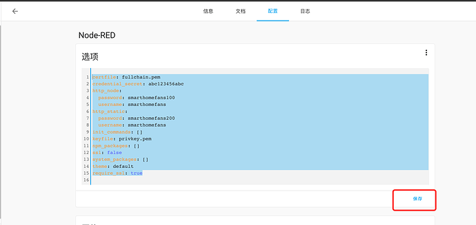

加载项重装nr之后,点击配置,然后上面三个点,,选择yaml编辑,然后复制黏贴下面代码,保存。
certfile: fullchain.pem
credential_secret: abc123456abc
http_node:
password: smarthomefans100
username: smarthomefans
http_static:
password: smarthomefans200
init_commands: []
keyfile: privkey.pem
npm_packages: []
ssl: false
system_packages: []
theme: default
require_ssl: true
然后启动nodered。
